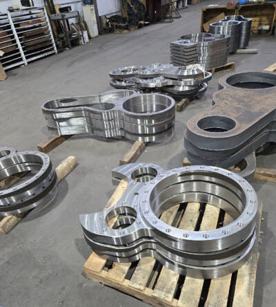

Components of the four cylinder sets are being produced at Dover Tank and Plate (Dover, Ohio), the same company that fabricated the new T1’s frame. Completed, each cylinder set weighs nearly 8,000 pounds. The sets are being manufactured as a number of individual parts.
Metal steam locomotive parts on a factory floor. T1 No. 5550 cylinders nearing completion.
Components of the T1 cylinders await finishing and assemble at Dover Tank and Plate (Dover, Ohio).

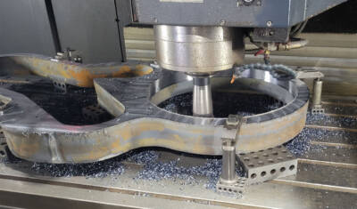

Before the cylinders are completed, the individual parts will be machined closer to the final size. The parts will go through a stress relief process where they will be heated to over 1100 degrees, held at that temperature for several hours, and then cooled slowly. Next will be additional machining  and welding the parts into cylinder units. The cylinders will then be welded to the frame. Once the frame and cylinders are aligned, final machining on the cylinder bore will take place. Unlike when the original T1s were built, lasers will be used to check the final frame-cylinder alignment, ensuring that the cylinders are precisely parallel to the frame.
Steam locomotive part being machined. T1 No. 5550 cylinders nearing completion.
Each component requires an extensive milling process before it is welded into one of the T1’s cylinder units.
To complete the cylinders, will require more than 2,000 hours of machining and around 1,000 hours of welding, says Jason Johnson, Trust general manager.
